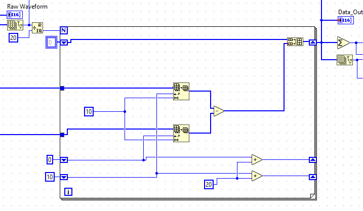

    I want to median calculated with 1D array,rule as below:
array[10]-array[0]
array[11]-array[1]
array[12]-array[2]
array[13]-array[3]
snapshot has done with  result,someone have other way simple to do that,thanks!!

Hi GerdW
    It seems not good,only 10 number is right,the rest is wrong,thanks!!
(1,917 Views)
Your VI will add 20 to the index after every 10 subtraction while GerdW's solution will not skip past any elements. If you want to implement it, take 10 element to subtract then add 20 to the index as how the original VI does it.
(1,902 Views)
   It's work,I desired that use pointer to handle this case,but I don't do it,who can give me idea to solve this case,thanks!!
