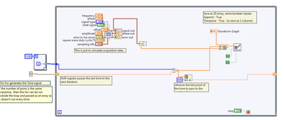

If you need the time column you need to generate that array before the loop (assuming that the number of points is known and fixed.
You also need a shift register to pass the last time to the next iteration and continuously add the time to the reading , then the saving function will be wired as a 2D array, with True booleans for Append and Transpose (to have it as 2 columns).

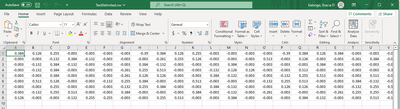

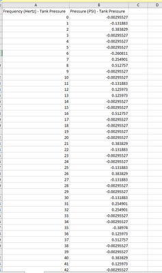

I am sorry for the misunderstanding. I meant " I am missing Frequency (Hertz) - tank pressure". Yes, you are right, the frequency column is static across iterations. It shouldn't change.
This below is what I want to get:
 Instead I get this below. when I tried to transpose and I only get one column (tank pressure)

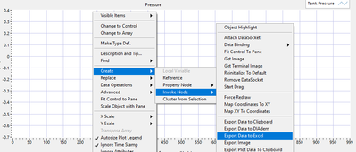

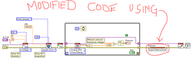

I would like to replicate what "export data to excel " invoke node
can do using "writing to text fileGRCK5000_2-1681260708120.png " , "tdms write GRCK5000_3-1681260772454.png "  or "write delimited spreadsheeGRCK5000_4-1681260864774.png
To use export data to excel, I did this below:
In other word, if export data to excel" wasn't existing, how would you write your code so that the .csv file looks exactly like what "export data to excel" invoke node can generate?
Now how would you write the code without using "export data to excel" so that the data on .csv file looks exactly the same as what "export data to excel" invoke node can generate?

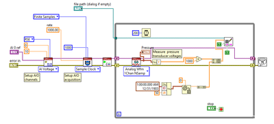

Yes, exactly. It sounds like you know exactly what I am trying to achieve. But this screenshot is the one thing I can think of.  Is this what you mean?
I don't know why this is being so hard. I can successfully generate the y-axis data, data on the x-axis is the only thing I am struggling with.

OK, lets' look at this:
You are creating a waveform with no Y values, a start time of zero and a dt=50, then you are using "variant to data" even though a a waveform is NOT a variant! to convert it to a single scalar DBL, then you convert it to a 1d array with one element which you then built into a 2D array with your data, but since it is much shorter (only one element), it will get padded with zeroes to match. There is no reason and logic to any of this! It's like a picture of a fish riding a bicycle! You can't just line up a cacophony of random functions and assume it is correct if the wires are not broken.

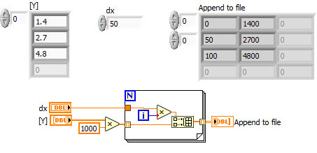

Here's is one way to create an x ramp from known dx and adding it as first column to the Y data. Y can be any size, of course. (Assuming x0=0, but it would be easy to have that as variable too).
