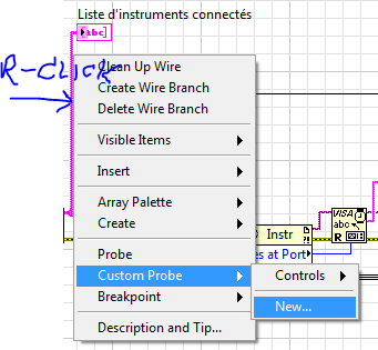

Create a new probe
at the pop-up wizard Select New and click next-
at the save prompt name the file StretchyString
A Probe editor (Like the control editor) will pop-up.  use the Right Click menu to do the following:
  • Visible Items- Display Style
  • Fit Control to pane
Close the editor.
Now go back to your BD and probe the write buffer with the "StretchyString" probe.  You can change the display style to HEX or \Codes and see if the termination charater is there.
