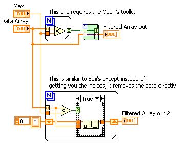

Below is a picture of two different ways to do this.  Both of them give you the data less than the max, rather than giving you the indices of the data that is greater than the max.  I'm not sure if this is what you were looking for or not though.
