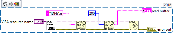

Perhaps you could try this VI? I haven't wired the inputs to the VISA Configure, because you've shown the defaults in your image - I'm sure you already checked but these should match the settings you have on the device - it doesn't seem to list defaults in the manual.
I suspect the problem is that you're not sending a termination character (LF) on the end of your query (at least that I can see). The display type of '\' for my string constant makes this easier to see. I can see how you would get the string you're sending from what I earlier posted - I apologise for the confusion, I used quotations to specify what you should send, but you don't need to send the apostrophes/quotation marks. Also, the termination character (IIRC) only affects Reads, not Writes, so you have to manually add the LF to your write commands. Usually, you can do this with Concatenate Strings, or similar.

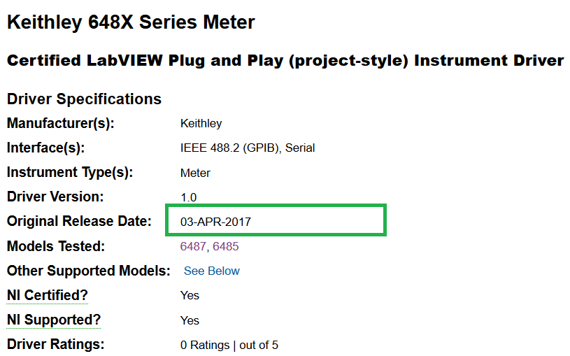

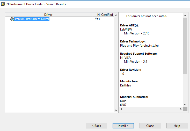

  4. Go to Help --> Find Instruments Drivers...
  5. Select "Keithley" from the "Manufacturer" list, and type "6485" into the "Additional keywords" field. You should see this: keithleydriver.png
  6. Select Install
  7. Now you can access the VIs under the palette menu: "Instrument I/O" --> "Instr drivers" --> "Keithley 648X series"

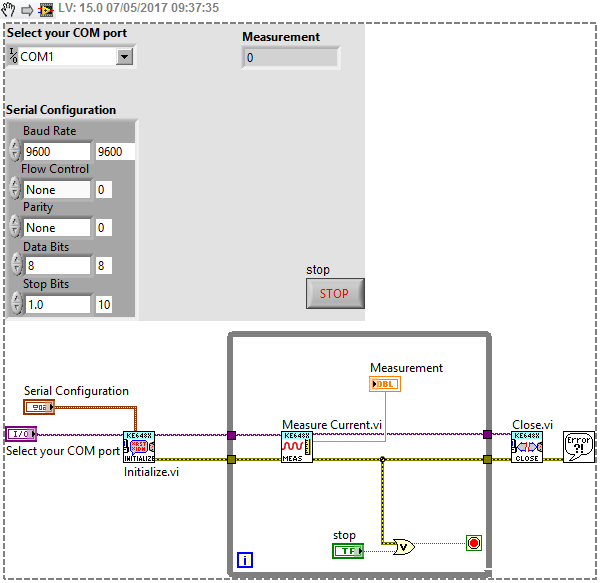

You can make a simple VI to test your RS232 connection works fine. For example, a simple picoamp Read test:
Tell us if you get any error msg, so we can guide you further.

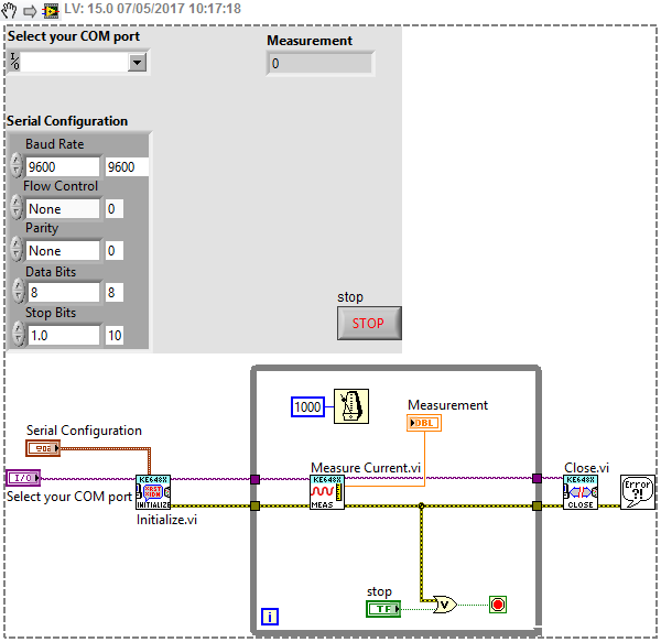

  1. I forgot to limit the speed of the While loop in my example, this is usually wise to do, see the snippet below where the reading set to 1 sec speed

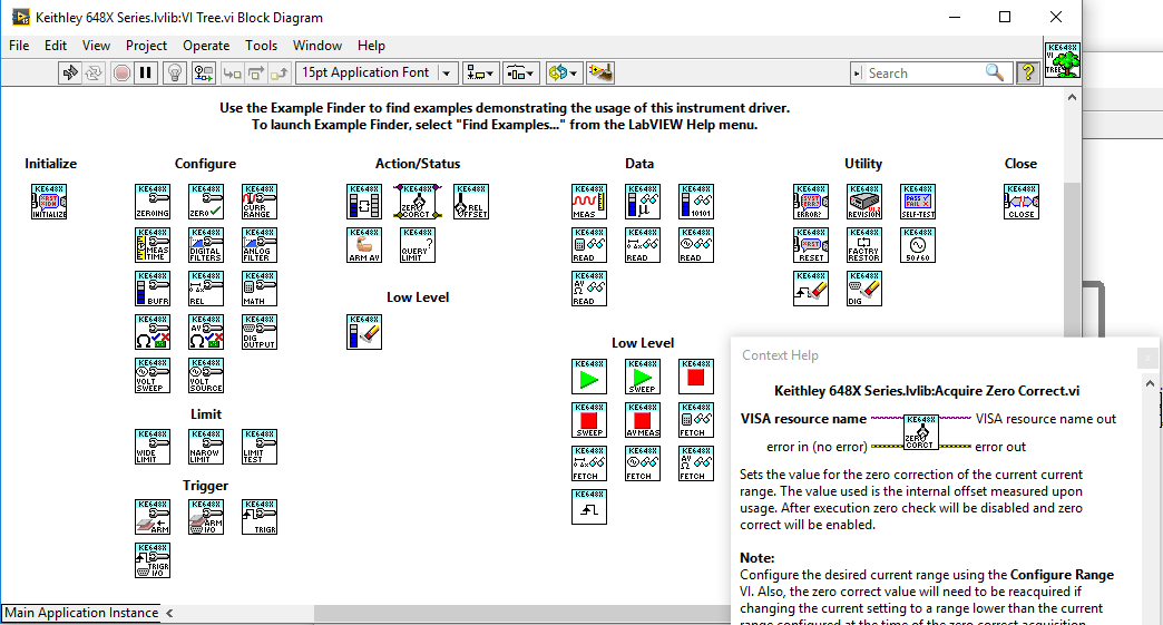

  2. Discover the different configuration VIs for your unit. If you want to do a proper measurement, you need to keep several things in mind. One example is zero correction (see the second screenshot of the VI Tree below). Also read the manual for further info, like around page 49...
