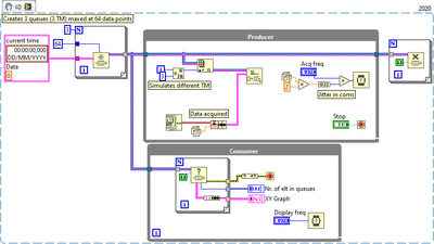

PS:
A quick illustration of my method currently implemented. In reality, having different data types and wanting to manage the XY graph, this solution isn't optimal as one small change creates a lot of issues across the application.

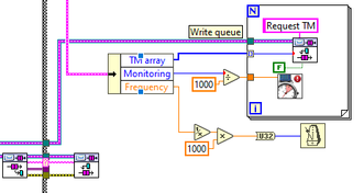

For now, my ugly method is to send the data analysed from the Coms module directly to my data display loop in the Device Control Module. This loop aggregates the data and displays it at a periodic time (different from the acq. frequency for performances issues). When I display it, I also send it to the Logging loop located in the same Device Control Module, which based on user request, will actually save it on disc or not (via a simple boolean and case structure).
It is not good, I know, this is exactly what I am trying to improve, but the multiple access point gives me a headache.
