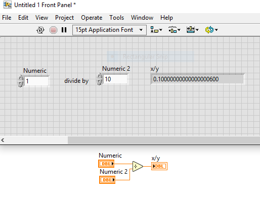

I think it has to do with the fact that all floating point numbers cannot perfectly represent decimal digits or fractions of a whole number. The chart is a guide to where you will start to see error in the number in terms of number of digits to the right of the decimal.
Example: Divide 1 by 10 and show the result in a double indicator, the chart says you get about 15 digits of precision, in this case we got 17 digits before error.
