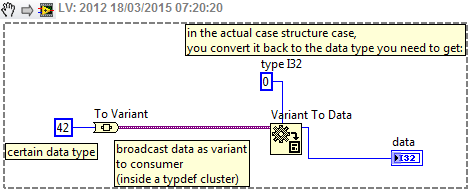

could you give me an example of how would I use a variant?

RavensFan described everything so you can create the mentioned typedef cluster with an enum and a variant inside.
I only show here how to convert your data into variant in the producer loop before inserting the cluster value into the Queue, and how to convert it back in an actual case in the consumer loop:
