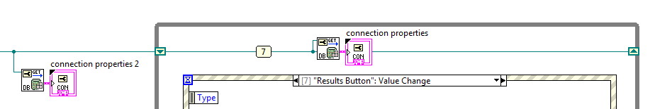

As shown in picture below, i have DB connection reference. "Connection properties 2" indicator shows proper values, but the same "Connection properties" indicator in while loop shows nothing, but connection numbers are the same (in probe). There is event structure in this while loop also if it matters. Why i can't get proper connection reference from while loop?
I'm using LV2011.

Try putting a timeout, such as 100 ms, on the event structure (upper left corner icon). By default it is -1 (wait forever until event).

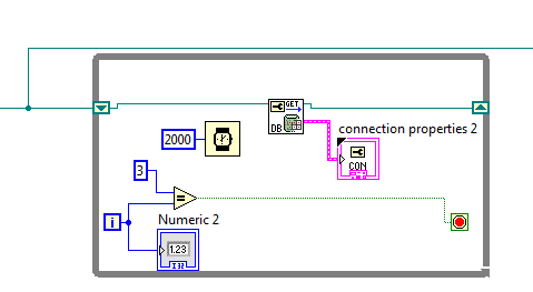

That's no problem. I fired this event (Results Button - Value Changed). This is strange problem - i attached next image.
When i run this VI, "connection properties 2" indicator shows proper values only in first loop iteration. After next iterations values are null. Maybe there is problem with ActiveX (ADO)? I'm using MySQL ODBC Unicode Driver.

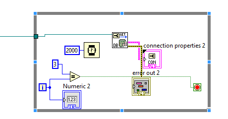

In addition - i have following error from 'DB Tools Get Properties' after first iteration.
NI_Database_API.lvlib:Conn Get Properties.vi->Controller.lvlib:Controller.lvclass:Actor Core.vi:1->Actor Framework.lvlib:Actor.lvclass:Actor.vi:7->Actor Framework.lvlib:Actor.lvclass:Actor.vi.ACBRProxyCaller.FC600014<ERR>ADO Error: 0x00000001
Property Node (arg 1) in NI_Database_API.lvlib:Conn Get Properties.vi->Controller.lvlib:Controller.lvclass:Actor Core.vi:1->Actor Framework.lvlib:Actor.lvclass:Actor.vi:3->Actor Framework.lvlib:Actor.lvclass:Actor.vi.ACBRProxyCaller.FC10001A

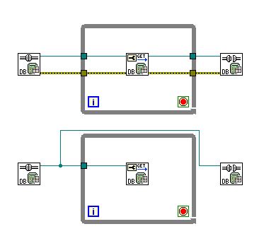

You are getting this error because you are closing the connection before you realize.  These two sections of code are not the same.  The bottom one will give the error that you are getting.
aputman

It's not the dataflow.
This doesn't work too.
It's strange, because i can use this connection reference before the while loop. i'm getting records from DB before loop (not on this screenshot). Problem appears in while loop after first iteration.
