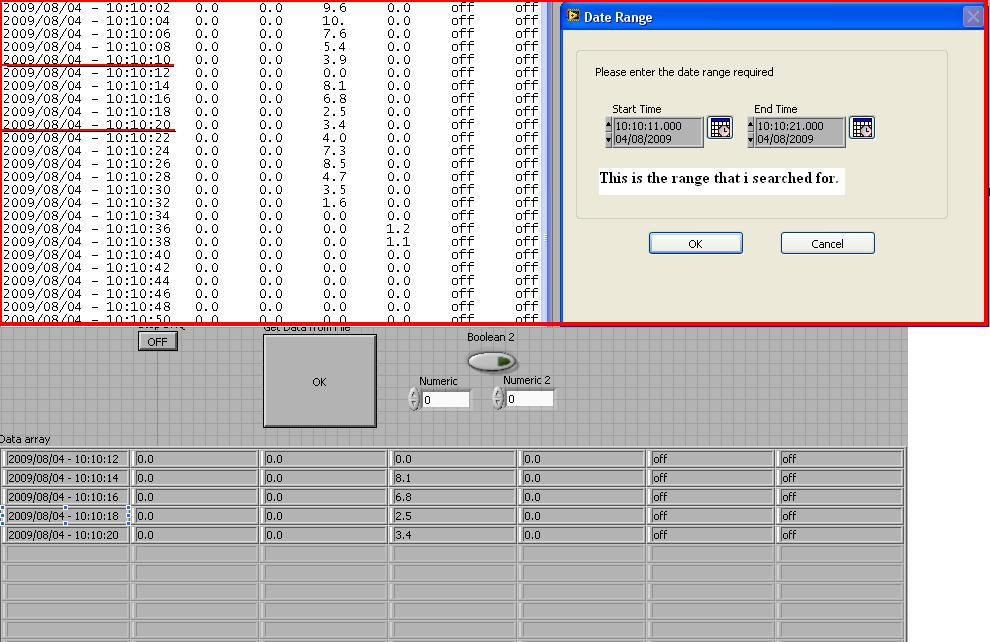

I have made a parallel loop in your program that will ask for a file to be searched and ask for a start and end datestamp.
These datestamps must be present in the text file prior to clicking the Get Data From File button.
The data stamps are accurate to 1 second but as I understand you are logging every 5 seconds and the program will
auto increase the search length for finding the next available date stamp.
If you set the acquisition time to 8 seconds the program will search for the next available timestamp in the text file 16 seconds after the one's entered this is required as there is not a date stamp in the file for every second.
let me know if this helps.
