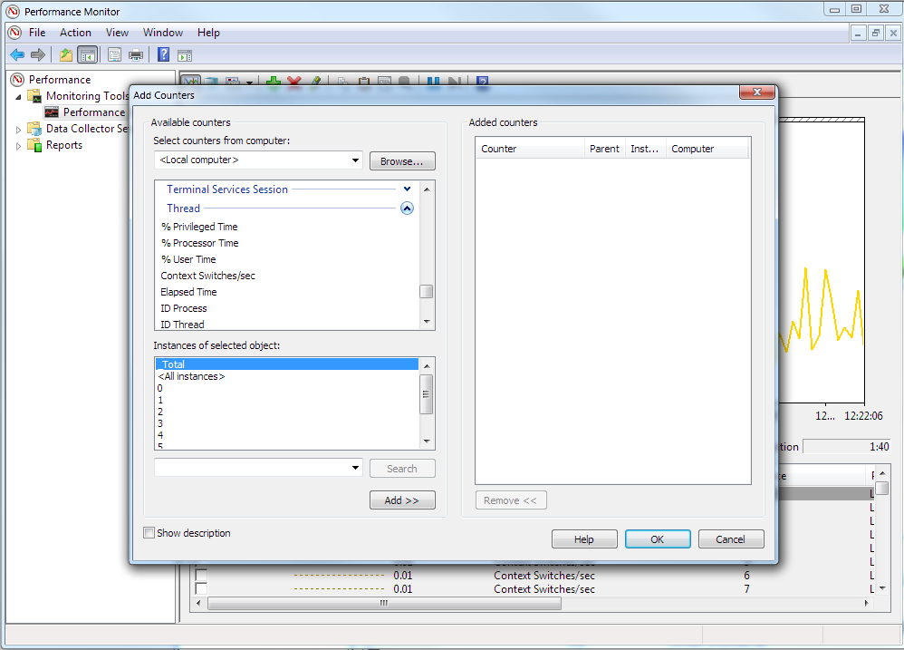

If you select the default Live view (Performance -> Monitoring Tools -> Performance Monitor), you can right click the graph and choose "Add Counters".
Here you are supplied with a huge list of parameters you can monitor, most of which I simply do know what they mean.

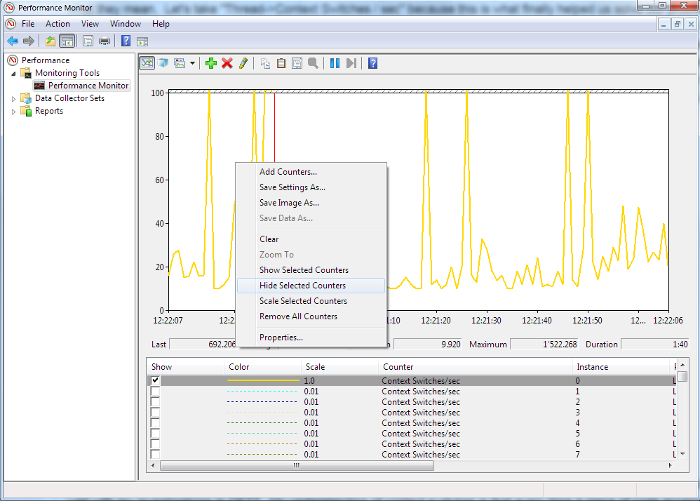

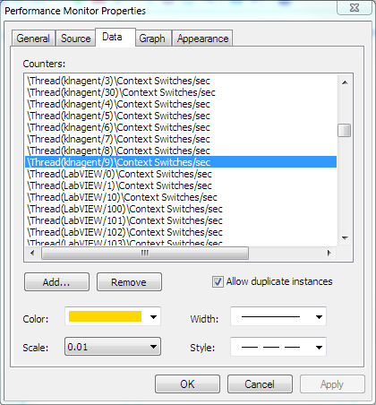

Let's take "Thread->Context Switches / sec" because this is what finally helped us solve our problem.  When selecting it adds the counter for every thread registered in the system which is a lot.  You will receive an error that not all can be shown on teh graph, not surprising since there are thousands of them.  We need to remove those we are not interested in in a second step.  Right-click on the list of items in the lower portion of the screen and choose "Properties".  In the image below I have located "LabVIEW" in the list.  I can delete all others from the list (Above and below) by selecting them and pressing the "Remove" button.  Do the same thing for the elements after LabVIEW.  Now the only threads shown should be labVIEW related.

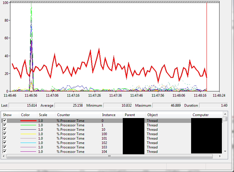

The Thread > "% Processor Time" in the Performance Monitor lets you observe how much of a single core each thread utilizes.
PerfMon Thread Processor Time.pngAs you can see in the screenshot, the UI thread is, during that period, causing 15-40% load of one core, while most other threads cause only little load.
You can of course also use the Performance Monitor on compiled applications. Just select all the threads of the application.

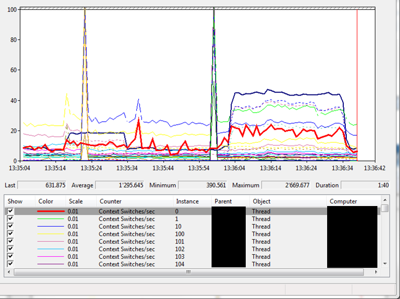

Back to Context Switches.
This is the graph before finding and replacing the affected bad controls (which would cause load with just the front panel open, not even running the VI):
PerfMon Context Switches.pngIt's very nice to see the effect of running/stopping different modules of the software and see the effect.
And this is after replacing the dodgy controls:
PerfMon Context Switches 2.pngAs you can see, the baseline of the UI Context Switches (Thread 0) went down from ~3000/s to ~800/s.
Our customers finally have a software that does not become sluggish over time.
