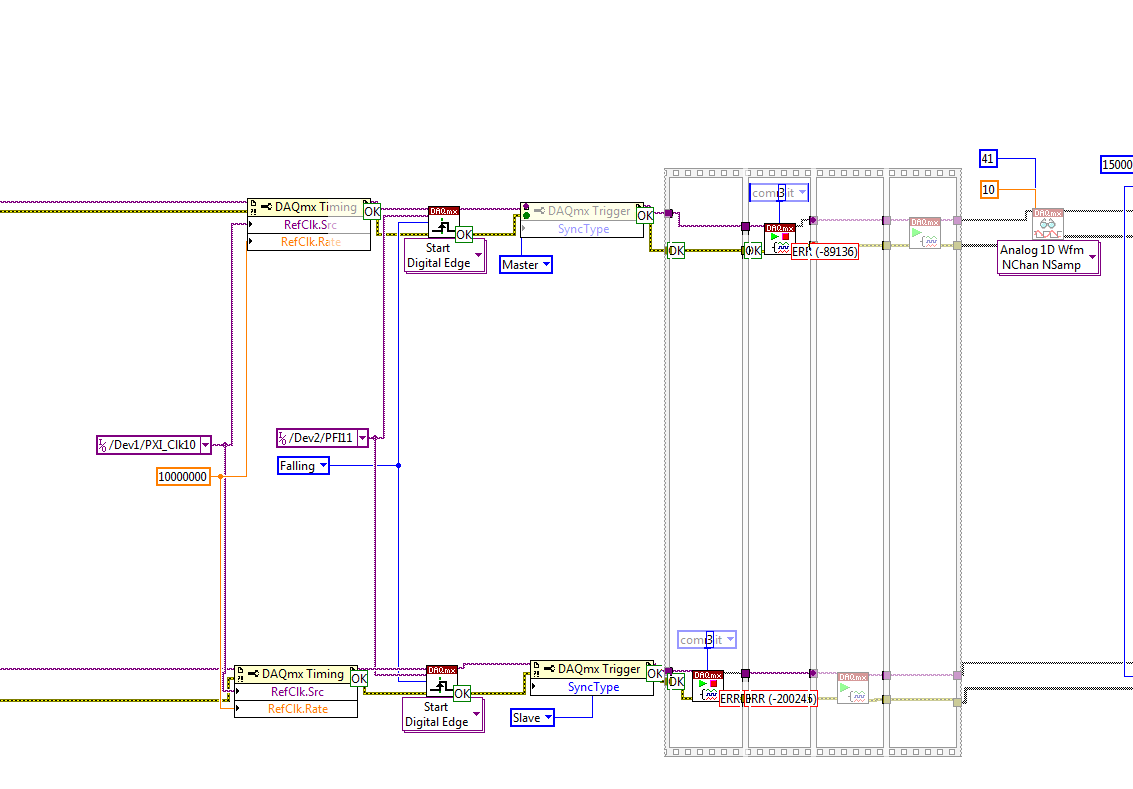

Hi guys, I am getting an error in DAQ when I perform debugging on the code. I am using 4330 and 6361 modules. I have attempted to synchronize the data by sharing the reference PXI clock and share a start trigger. The acquisition is finite. Any suggestions would be appreciated.

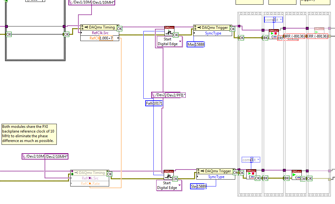

Mike - Thanks for the immediate reply.
I am trying to synchronise the signals from the two modules using the phase loop circuit (PLL) of the PXI_CKL10 reference clock. This will cause the time base of all boards to be synchronised. I changed the vi as shown below. The error is because the hardware does not support the route of NI PXIe 4330. Is there any way to route the signals thought the module if this is the problem?
Message 3 of 9
(4,459 Views)
For the syncrhonisation, the modules support the following
4330 -- Onboard 100 MHz clock, Backplane PXIe_CLK100             ----   Internal frequency 100 MHz with accuracy of +- 50 ppm
6361 -- Reference clock locking frequency for Phase-Locked Loop (PLL) PXIe_CLK100
In the manual it states that external wiring is needed..Is it possible anyone to advise me on how to do this please?

Already done that..so the one module will need to be routed throught the PXI trigger??

Did you read that link ?
https://knowledge.ni.com/KnowledgeArticleDetails?id=kA00Z0000019LYVSA2&l=en-US
It should show you which rout is available for your hardware. Up to you to choose the right one.

I will reverse the tasks; master the task where the trigger is connected to as I had them in the opposite direction.
