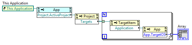

I tried it in small VI, but it didn't resulted as I expected. The code i used is the following:
As result, I've got an array in which the first element is the operating system of my computer (windows) and the second is a Linux, although the target is a (real-time) compactRIO, so this method doesn't seems to solve my problem.
