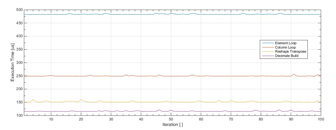

It took me a while but here are my results:
I used altenbachs benchmark and included the decimate and build just out of interest. Its not really applicable beause scalability is more important than speed (at least if we're talking µs).
The test was run on a PXIe-8135 Target with 8 rows and 7200 columns of data.
(The results on my LabVIEW VM are pretty much the same but with a lot more jitter).
Would reshape and transpose be my best option according to the results? Regarding memory allocations altenbachs column loop would be better, yet reshape and transpose runs a lot faster.
Thanks for your input!
