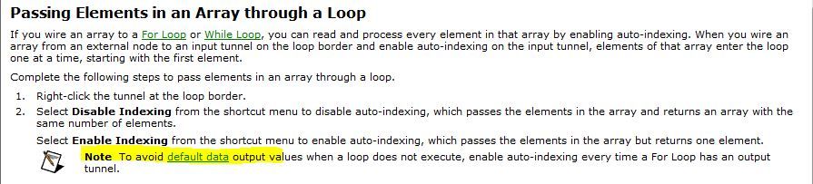

Where is this documented in LabVIEW?
aputman
Message 4 of 19
(8,019 Views)
That is one confusing help sentence that does not make any sense!! The words "returns an array..." need to distiguish between the value inside the loop and what's returned after the loop. It currently is ambiguous.
Let's assume it talks about what the loop returns after completion (because it also talks about "default data" output).:
Point 1: This is incorrect when the for loop iterates 0 times (e.g. if there is another autoidexing array with zero elements). You'll get empty arrays at the output if you also don't autoindex at the output tunnel.
Point 2: Even if you enable autoindexing you'll get the "default data", i.e. an empty array of that datatype after the loop. So what's the difference???
This help page has been slightly rewritten for LabVIEW 2014 (see here), but does not seem any clearer.
As has been mentioned, use a shift register to pass data across a for loop even if the number of iterations is zero.
Message 5 of 19
(7,996 Views)
Smiley Frustrated  I didn't even read the whole thing when I posted the image.  But you are right....no matter how it is auto-indexed, default data is output when the loop is not run.  Is this a feature from the early days of Labview that has since changed but managed to stick around in documentation?
