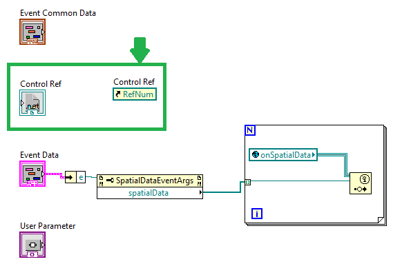

Do I have to change the Spatial Data Event Callback? In the subVI called onSpatialData? I'm afraid of screwing up things more! But it seems the right place to change the RefNum!

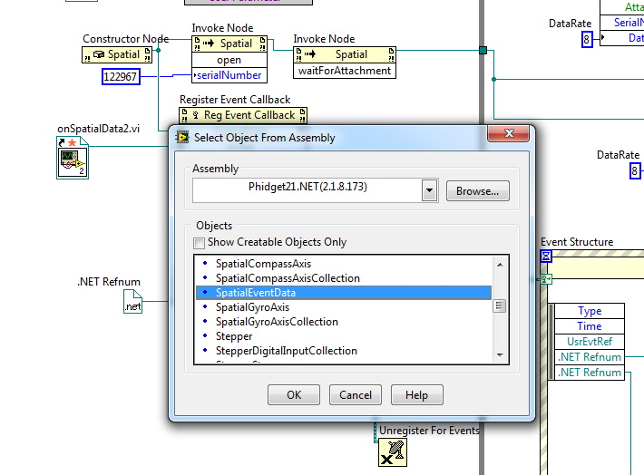

Phidget is the name of the manufacturer of both sensors and they also name them phidget, the ones im currently using are the phidget spatial 1056 and an older version phidget spatial 1049.
-I know that is the problem, the data is being sent to the both graphs at the same time.
-Yes that is why this is happening, same .Net refnum but i dont know how to change or if that is even possible, i found this:spatialeventdata.png
But i think im forced to pick the spatialeventdata, so the refnum will be the same, I was thinking about renaming this or something but i dont know how, i even searched for Phidget21.NET in my computer but the files i found could not be renamed with my knowledge.
-I tried using 2 loops but te problem remains, then I tried to use a flat sequence structure on both while loops and I found something nice but it's not what I am looking for, with the flat sequece structure it starts to send the data of just 1 sensor into just 1 graph and when I stop that loop the other loop sends the correct data to the other graph, the problem is that I need them to work at the same time 😞
-Yes, the files are the same i simply copy pasted a new one and renamed it, i tried this because I tried a diferent way to do this but there was a delay, its a very long story, but the important part is that the other program had the same problem (data being merged together into 1 graph) and Phidget support told me that i should just rename the blocks and it would work, that it was an ugly way to do this but it should work, and it did.
