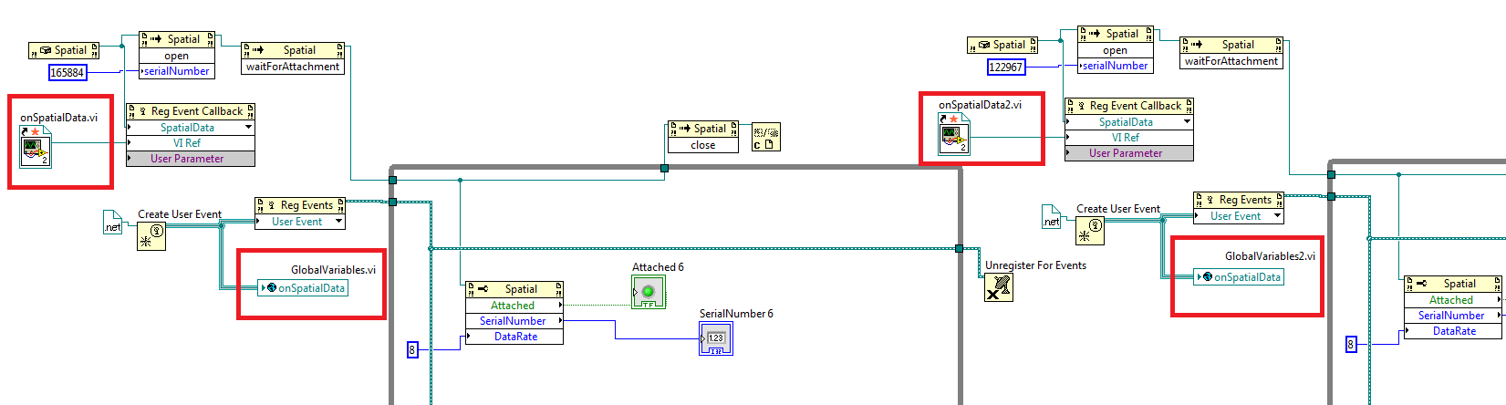

This is what I did after reading your post udka, I deleted the sequence structure since I want parallel. Then I went to the folder where the original program was and copy pasted the 2 subvi (onSpatialData and GlobalVariables) and changed their names, then i swap them in the right part of the code, where u can see the label is diferent with their current names in red, then I also moved the unregister for events to the right side of the loop as you mentioned before:
But this still doesn't work, because I dont know how to change the user event queue, can u explain a bit more how I can do this? I tried to google it and I couldn't find anything that helped me on this.... Sorry for being so ignorant in LabVIEW lol !

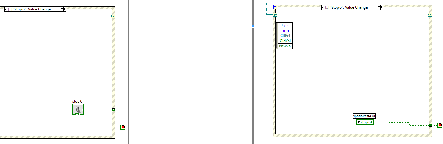

Then I tried to use single stop button to stop both loops, this would be great when implemented so thank you for telling me this tip, but even after trying so many diferent ways to do this LabVIEW always had an error, (If a Boolean control has associated local variables, it cannot use latch mechanical action. The first local variable to read a Boolean control with latch action would reset its value to the default.)! I searched for examples in the LabVIEW help and did the same as it is in the example called "Stopping Parallel While Loops without Reset.vi" and now it looks like this:
The error is still there but I dont know how to solve it....

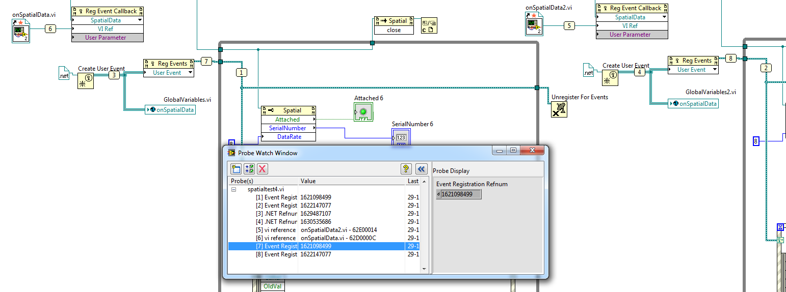

This is what I got on the probes:
Of course the probe 1 and 7, and the 8 and 2 give the same Values because they are on the same wire, I just did that out of curiosity lol !

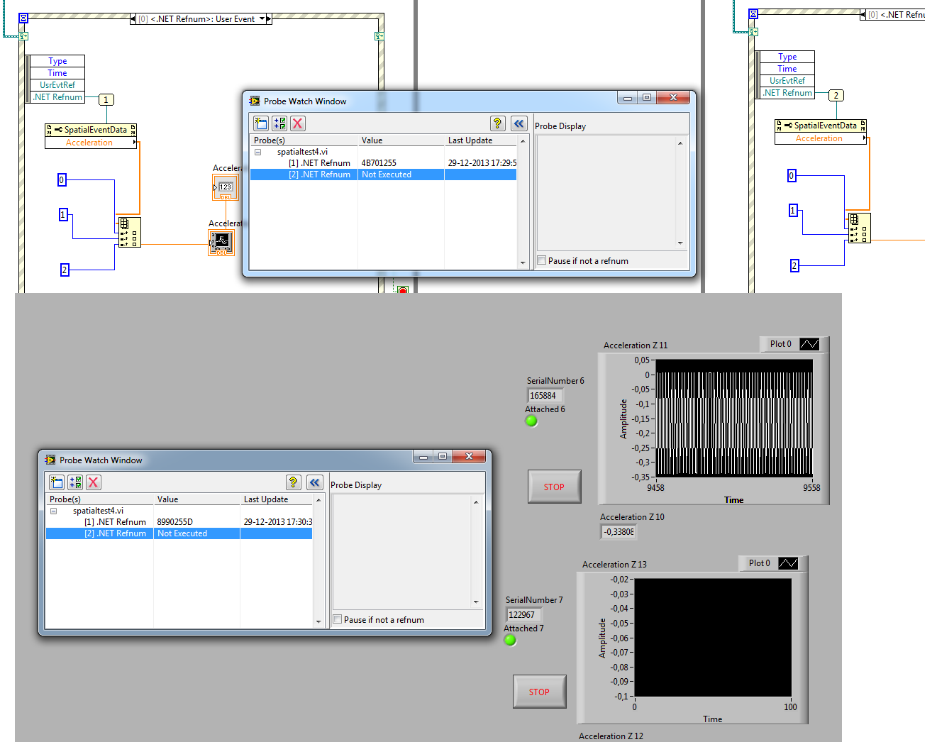

Sorry for the spam.... but I probed inside the case structure as u mentioned too and found this:
 The value of the probe 1 keeps changing very fast and the other one is not executed, but the top graphic shows the data aquired from both sensors.
