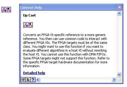

If the FPGA targets are of the same class, LabVIEW has an FPGA up casting operation that will create a more generic FPGA reference. The up cast configuration offers many different options for the defining the FPGA reference for interface control. Please see the screenshot below:
Maybe, this is closer to what you were looking to implement? Perhaps, I misunderstood you initial question. Please post back any follow up.
