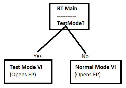

Thank you for all your replies.
Here is what I have done so far:
HOST: Writes a configuration file on the RT target, with a Testmode = True / False key.
RT: Has 1 main application, that reads the key. Based on this key, it calls either VI1 or VI2, which has two different FPGA bitfiles.
This seems to be working, so I think I will be using this method.
I have a couple of questions:
1) When I develop the RIO code, I use indicators on the FP, to give me some kind of debug information. When I deploy my code to the target as an RTexe file, I believe these indicators is getting stripped away, and thus the RT exe has no FP at all. Is this correct, I have not been able to find documentation that confirm this?
2) This means, that with the new setup, where the main application reads a config file, and then calls a subVI, that this subVI was previously my mainVI with all the indicators (I hope this make sense, hard to explain 🙂 ). Thus, I want to change the subVI settings, so that the FP is shown when called. This is working fine when developing and running the RT code from LabVIEW developer mode. But how does this behave when I build the RTexe??
