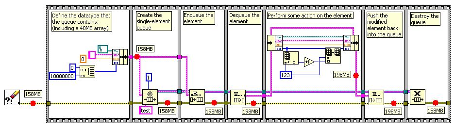

Then consider the following code example where I have noted the memory usage as reported by Windows Task Manager at several points in the code.
From this it is clear that although there is a dot indicating a copy at the Dequeue vi, no copy is actually being made.  The data element is only created and memory allocated when it is initially pushed into the queue.  So repeated dequeue-and-enqueue pairs are very efficient at accessing data from several points in your code.  The dot just confuses me a bit but I can live with it.
I understand your argument re what would happen if another process Enqueues another element into the queue when this one has been dequeued, it seems that the memory is allocated when the element is enqueued (note the dot on the first enqueue element call) not when it is dequeued.

One point to stress in this thread is a buffer allocation is NOT the same as a copy. The buffer allocation at the dequeue element is LabVIEW creating space to store your data. This space is NULL until there is an element in the queue. There is space for one element in this buffer. When the value is taken from the dequeue element space is made for the next element.
The big thing to note, which you already discovered, is that we are not making copies in a queue.
