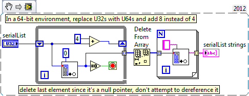

You can combine the approaches for 2D Arrays and strings described here: https://decibel.ni.com/content/docs/DOC-9091. The difference is that the first for loop will need to be a while loop, where you stop when the dereferenced value is null, because you don't know the number of items in the array to begin. Then, you'll use the method for dereferencing strings in a for loop, once for each element in the array generated in the initial while loop. It will look like this:
There's a way to do this with MoveBlock, too, but it is much more difficult because you'll have to find the end of the strings.

It would help to post the VI that calls enumerateUSB, I can't follow your comments about strings. There's no reason you'd be using string to byte array here. The wacky string value is the result of taking a value that is actually a memory address and trying to display it as text.
Ignore whatever the DLL import function is doing here. Configure the Call Library Function Node so that you're passing the serialList parameter as a pointer-sized integer, passed by pointer. The value that's returned will be a pointer to the first string. When you increment that value by 4 bytes (or 8, on a 64-bit platform), you'll have a pointer to the second string, etc.
A pointer is a 32-bit value on a 32-bit platform, and a 64-bit value on a 64-bit platform. The eventual target of the pointer doesn't matter in the initial DLL call, you only care about passing around numbers which are actually memory addresses. The value in serialList is the first element of a null-terminated array of memory addresses (ie, an array of U32 or U64), which you need to dereference to get to the strings (which are null-terminated arrays of bytes/chars).

Thank you so much.
I had tried all of that beforehand, but I was passing it as a value and not a pointer, causing it to crash.  D'oh.
The rest works great... the only thing you missed was that the next function accepts a pointer, not just the string, so the second loop was unnecessary.  Still works out though!
Embarrassing that this all came down to confusion with datatypes!
