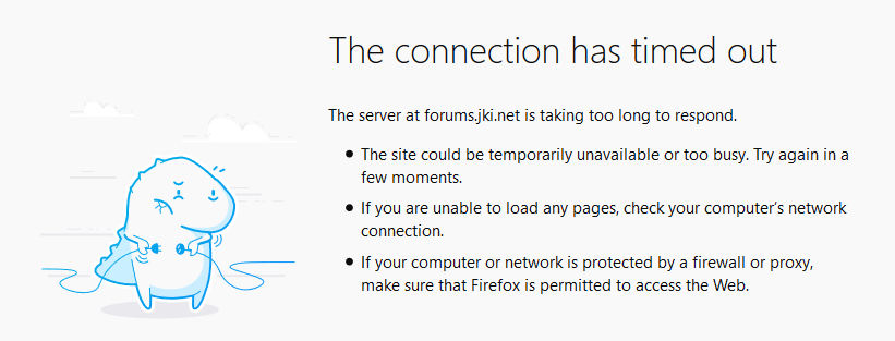

For what it's worth, I tried looking at their member page to see if my account was at least listed there, but that didn't work either:
