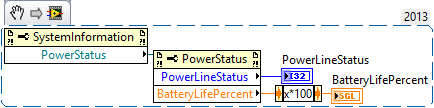

However, this is pretty easy in .net:
https://msdn.microsoft.com/en-us/library/windows/desktop/aa373231(v=vs.85).aspx
If you dig around you can even get a .net callback event so you don't need to poll the status:
https://stackoverflow.com/questions/5378449/c-sharp-raise-event-on-powerstatus-change
If you arm the .net callback VI with a user event, you can catch the status event in a normal event structure, so it fits in nicely with the rest of your program.

I think the ".NET" approach will do the trick 🙂 !
I'm have not used ".NET" that much, so I can't seem to find "SystemInformation"...
Under what assembly do you find the "SystemInformation" ( Select Class-> .NET -> "Browse" ) ?

I have tried to use the "SystemInformation" -> "PowerStatus" to detect the change in the "Online/Offline" value and it does not work since the UPS immediately kicks in (the power status stays the same). This is a desktop PC which has no battery other then the UPS, so there will not be any power toggle (Online/Offline). The only confirmation I get on power failure is from the UPS itself that triggers the pop-up message ("You're about to be signed out"). So what i'm looking for is the "event" itself and I found this:
