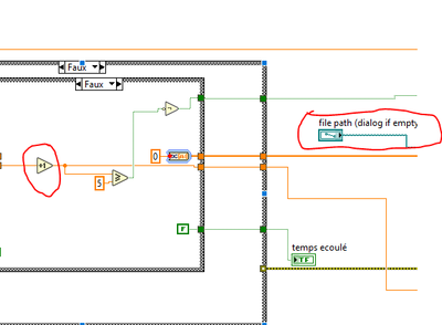

I need to know how I can detect the path change state of my excel file, to set my counter to zero, if the state changes, I was thinking of an event structure, but I don't know how to use it, is it that there are tracks or example for this kind of problem, thank you to all.

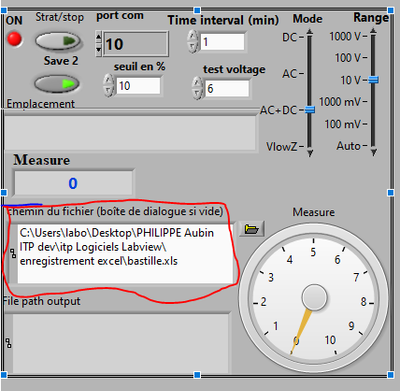

I want once the file path is changed by the user, at this time I have to detect this change to reset my register to zero, the change of path t is manually writing by the user during recording File,I hope you get the idea

Use an event structure with a ValueChange event for that filepath control...

Using a simple path shift register I was able to solve the problem
