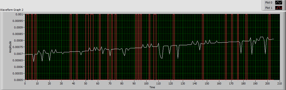

Hi Sarah,
so you want to find subsets in your array where consecutive elements have the same value?
Use a loop and compare current element with previous one: if they are the same you have found a "plateau"…
Result of this very simplistic approach:
Plateaus marked with red plot…
