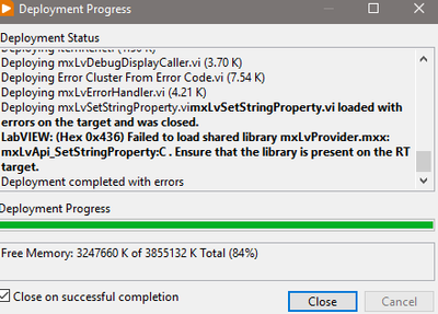

Hi Bob Schor,
I am also trying to read RT application version on cRIO 9049 and on IC-3173, I tried 'Get Build Specification Version' from Application Builder sub-Palette, but it throw an error while deploying code:
It seems my RT target is missing mxLvProvider.mxx. After searching on web, i found mxLvProvider.mxx is available for windows not for Linux system.
Can you please help me to understand how to install that supporting library on my cRIO     OR      is there any other way to read RT application version on Linux system?
Thank you,
Ashwini A Pandit
Thanks and Regards,
Ashwini A Pandit

@Vijay_J wrote:
I got that after reading your reply.
.Net as well as Win32 API wont work with RT.
It's not just .Net or the Windows API that is the problem here. This version information is stored under Windows in the version resource inside the PE (Portable Executable) file format for Windows EXE and DLL files. Other OSes have none or different means to store such information. Apple MacOS uses bundles to store that information as part of the executable file (its really a directory structure containing the binary executable resource and various XML files with the information, but the MacOS Finder will treat it as an object that you can't easily browse into.
Linux has in true Open Source tradition no standardized way to do this 😁. Each desktop manager tends to do it in its own way. Accordingly the NI Linux RT build executable do not really utilize the version information that you can provide in the according Build settings in a LabVIEW project! I have solved this usually by adding a specially designated VI to each rtexe build and a pre-build step that extracts the version information from the project and stores it in that VI and some utility function in the exe that retrieves this information from the VI to use in application about dialogs or remote version queries. Unfortunately this does not solve the problem to identify the version of an rtexe file on disk without running it in a target. And to the best of my knowledge there is no way to do that other than adding an additional functionality to above mentioned pre-build step (or maybe rather a post-build step) that would create an extra file along the rtexe that simply is a text file containing the version.
It's these kind of low level problems that always makes me wonder a bit, how much the LabVIEW developers have actually thought about features. It would be relatively little additional work for the LabVIEW developers to provide such features as built in capability. The same mechanisme could have been used for PPLs too, instead of packing PPLs into a PE file under Windows to have that version capability, but leaving all other platforms behind in that respect.
Rolf Kalbermatter  My Blog
