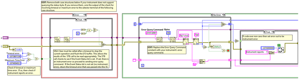

The generic "Error Query.vi" is shown here:
Spoiler
I wonder what would be the best way to alter this VI without changing the generic error handling idea in this generic project. My idea is the following, please comment whether this is the proper way to go, or not? Thanks! 🙂
So, whenever any of my driver VI captures a "NAK" error response instead of a proper "ACK" response, I would generate an error into the error wire right in that place, plus calling a modified "Error Query.vi" (actually I would rename it to "Error parsing") to change the NAK code into the string part of the custom instrument error, error code -1074000000. Thus this error can propagate through any other VIs, and also outside of the driver API VIs. It is up to the programmer, if she or he wants to erase/handle/etc this driver error in the calling codes.

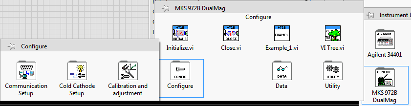

I just finished developing the first version of the driver (find it zipped in LV2015 and LV2017 versions, project style).
I tried to follow the guidelines as much as I could, but for sure there is still large room to improve it 🙂
I implemented almost all the features of this sensor, except the Relay functions, due to the fact that my sub-model does not have relays. Otherwise I tested almost all the functions, and they work nice and reliable in my application!

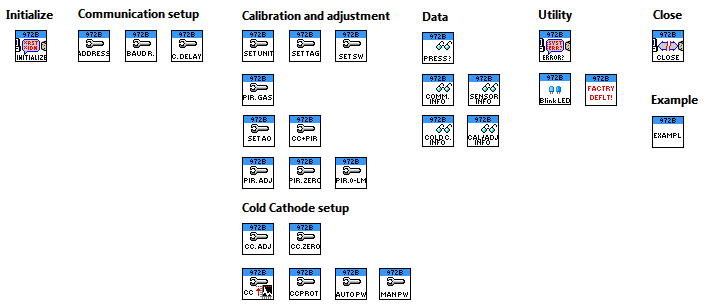

  1. I set the proper termination characters at the Init:
    ;FF

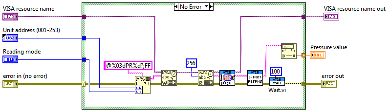

    I give enough timeout for the VISA. Still, the device was throwing timeout errors. So I included a 100 msec wait for all the subVIs (not between the VISA Write+Read combos, but after each request; it seems the sensor "does not like" if we poll it without little waits between functions. EDIT: here is a snippet explaining this: Read pressure.png
  2. I managed to create a nice palette set with custom subfolders and generated the mnu files ok. However, when I back-saved the whole project into LV2015, the imported driver folder under the instr.lib lost its custom subpalette icons. Is there a proper way to migrate such project style device driver?
  3. Below I show some snippets and screenshots. I will also submit the driver "as it is" here: http://sine.ni.com/apps/utf8/niid_web_display.sub_driver   But if someone needs this driver, just download it from here and copy it under the instr.lib folder. Note: you might need to manually add the top level mnu palette file, it did not work for me automatically, even after LV2015 restart...
