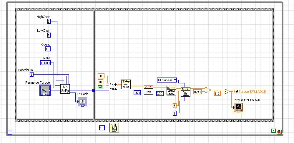

I need to set a read analog signal, but in this port configuration the error occurs 41.
Maybe it's the memory configuration of the PCI in 2511, but do not know how to configure it otherwise.
Follows the current configuration of the image.

I'm not sure what device you are using, but before trying to code a device in LabVIEW, try "manually" gathering data from the device using MAX.  When you do so, pay attention to the parameters that MAX asks you to specify.  Indeed, if you get a configuration that gives you the data that you want, save it (in MAX) as a Task and wire that Task to DAQmx calls.

You'll have to contact Advantech to find out what error code 41 means.  MAX won't help you since this is not an NI product.
Why are you writing to an indicator and a local variable of that indicator at the same time at the end of your loop?

I understood, I will contact the Adventch then. I'm using this local variable in another program loop. This variable is read in another loop, following the program, so it's there at the end of the cycle. This cycle is later than that of reading, is it ok? or not? I do not have much experience with Labview.

You don't need to write to the local variable.  You are likely duplicating that value in the chart as a result.  (Unless that local variable is actually pointing to a different control than the chart, and you happened to give them the same name, which is a bad idea because it is confusing.)

But still the problem of error 41, accusing perssite of memory error, I believe that should be the interaction of the loops.
