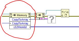

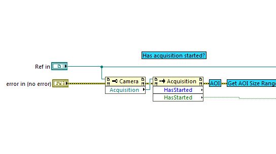

Acquisition refnum doesn't get closed.
Is there a method to dispose Memory ?

Hi George,
Thank you I'll go back and close that reference. Are you asking if the camera has a "Dispose Memory" method?

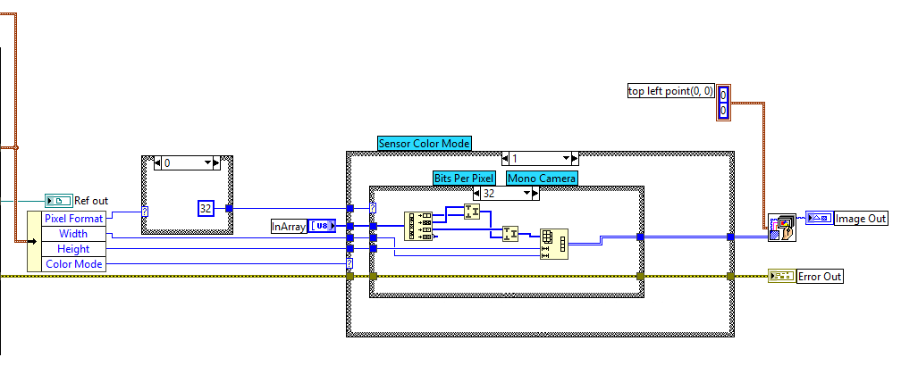

Hi all,
When the image is converted to a picture, the input array is decimated and joined (I guess to create the RGB format) and then resized. I have heard that continuous resizings can hog the memory, is there a better way to do this?

I do not think this is your problem, but it may reduce memory a bit. The decimate array is probably the fastest solution, but each output array has its own memory space. I think LabVIEW should be reusing those buffers for each iteration, but who knows. I have something from years ago that is similar, a Princeton CCD camera, you should modify for your purposes. I did the following to save a bit of memory.

Wire an invoke node  to Memory, see if you can find a method of Dispose.
Some C# objects require users to call Dispose explicitly before close.

Hi George,
The .Net interface does have methods for "Allocate", "Free", and "Clear" memory. The Allocate method is called when the camera initializes.
Allocate: Allocates an image memory for an image
Free: Releases an image memory and removes it from the driver management
Clear: Removes all image memories from the sequence list
As far as I can tell, the Active s32MemID stays at 1 for the duration of the program, so I don't think I want to use the Free method until closing the camera.
