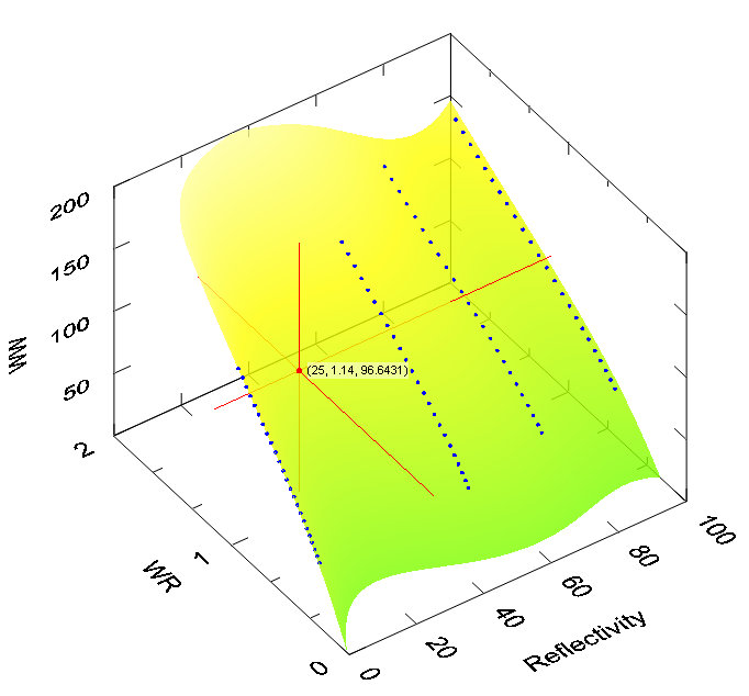

Of course you don't really have enough data in the reflectivity dimension to justify higher orders.
(For the graphs below, I am using a 3D graph with 2 plots:
(1) 3D curve with the raw data (dots)
(2) 3D Surface with a grid of generated data from the best fit coefficients.
I also show a 3D cursor locked to plot 2.)
For example with Polynomial order=4, a full 3D graph from the coefficients looks pretty good.

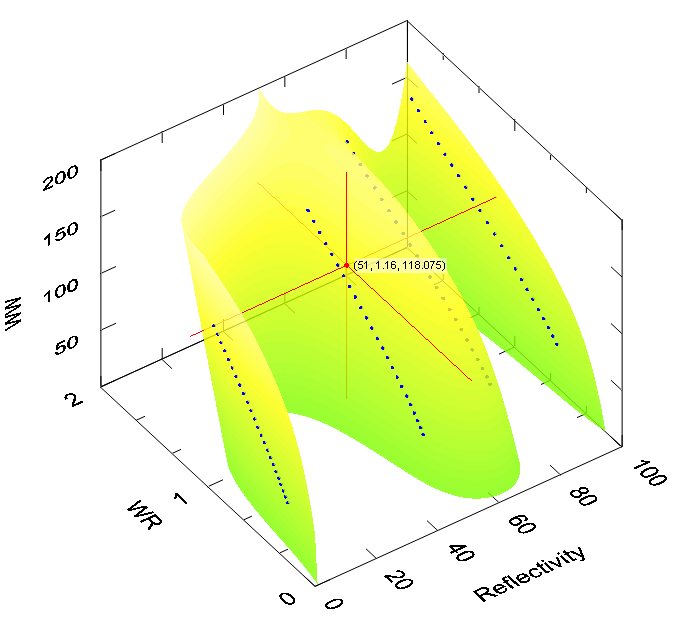

However, if you would do a 7th order fit on the same data, the fit gets better but the full plane looks not very reasonable. 🙂
