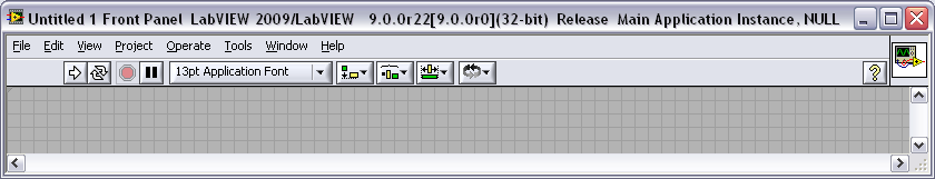

You can add the following item to the LabVIEW.ini file to help you out. It will display the version and exe path of the version of LabVIEW that is running in each window's title bar. The downside is that it's a little verbose, but it helps!
showExePathInWindowTitle=True
