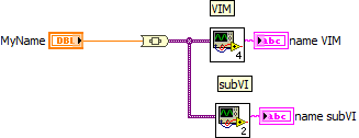

I want to use the Variant data parsing tools to find the name of a control or indicator. The code is simple. See below.
If the code is run in the subVI I get the correct result. If run in the VIM I get the name of the VIM Control. If I try to use the subVI in a VIM, I get the name of the VIM control.
Can somebody let me know why this doesn't work in a VIM?

Interesting...The tool works on an element inside a variant, but in the VIM, the variant is formed (by coercion at the input terminal of the tool) after passing trough the generic connector named "variant", so the content has the name of the input terminal
The VIM operates on the value of the control and the label is not part of the value. In the subVI version, the coercion to variant happens at the input, so the name is part of the variant data.

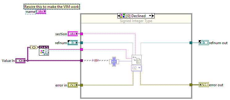

I wanted to wire different values to a configure file, have it automatically get the name of the control and write. I know there exist some variant solutions, I thought I could be clever and write a VIM.
Attached is the VIM, but you would need to rewire the name to make it work, otherwise all the names are "Value In". The Get Name from variant doesn't work as you noticed.
