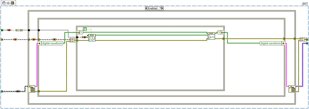

I have a boolean array of 96 IO lines per transfer coming off of an FPGA FIFO, (no DAQMX)
I'd like to be able to display this data, however, the act of converting this data to a digital waveform is terribly inefficient.  1 kHz is more than my i7 can handle at this point, heres the code, the DVR is not blocking.

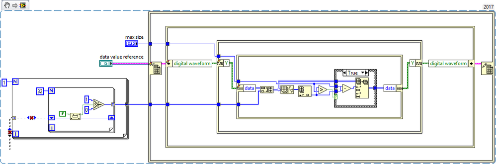

Anyway, here is the solution:
solution.pngsolution.pngThe bigger problem was "Append Digital Samples" vi.  This code can easily handle 1 Gbits/second throughput on my laptop, the old code does less than 20 kbits/sec.
I think the tools for digital waveform manipulation could use some work.
