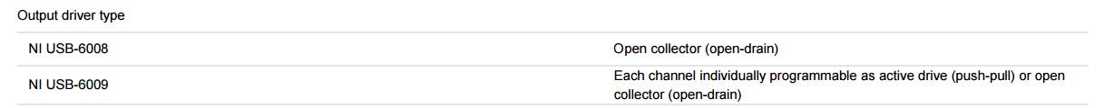

Then I searched the specification of NI 6008 and Ni 6009 and found this.
In the program, this property is set Activie drive. But seems usb 6008 doesn't have this function. Is there any method that I can use 6008 to acheve function same as active drive?
Thanks.
Message 5 of 14
(5,050 Views)
You would need to add external circuitry to add an active driver to the USB 6008. Are you sure you need active drive? The USB 6008 will still output 5V when the output is on, it just can't supply much current at that level. For signaling purposes such as SPI it should work fine.
