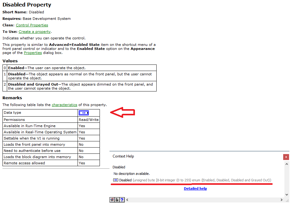

that property node expects an enum value, so to remove that coercion dot you need to wire the correct enum…

It used to be a plain u8, but it got changed to an enum.
I can't find where it states the value is an U8. But if it is there somewhere, I guess they forgot to change it.
My help says:
Values
0 Enabled—The user can operate the object.
1 Disabled—The object appears as normal on the front panel, but the user cannot operate the object.
2 Disabled and Grayed Out—The object appears dimmed on the front panel, and the user cannot operate the object.
Right click and create a constant to get the correct enum.

  • Yes, to get the correct input, right-click ... create {control | constant | indicator} is always the best way.
  • The help and context help show that blue icon with the two triangles (picture). That's an enum. A numeric U8 would show a blue "U8".
  • (On a related topic, your image shows the Rube Goldberg way to create a U8 input. The correct way would be to right-click the numeric and simply change the representation 😄 No conversion needed...)
  • That coercion dot does not cause any problems, just code readability issues. Coercion dots are not always bad.
