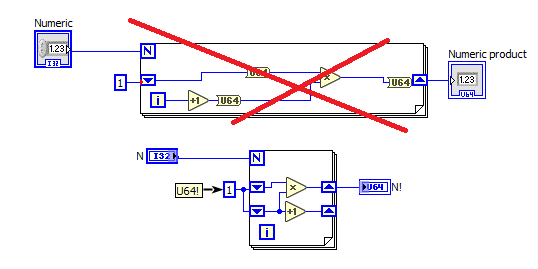

In your original example, both results are wrong because the indicator has the wrong representation.
As others have said, a factorial is a very rapidly growing function and will exceed the range of simple numeric datatypes very quickly. Even DBL can only represent about 15 significant digits, so the result for larger number is only an approximation.
You really need to put a little bit more thought into it, for example in your second example (third version) there is no need to convert to U64 three times. Initialize the shift register with a U64 of 1 (I assume you know how to change representation), but even for U64, you'll quickly run out of range (the largest number is 2^64, or 18446744073709551615, which is smaller than 21!). And no, the "Numeric" can stay at I32.  Compare:
