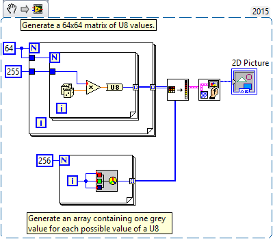

Kindly, how can I display (write) a gray scale image in labview using Flatten Pixmap when my input image is a two dimensional matrix 64x64 gray scale.?

One way of doing it would be to wire an array representing a greyscale colour map to the colors input of Flatten Pixmap.vi.

@Tasnim wrote:
in case I want to read a gray scale image in labview using Flatten Pixmap.vi or Unflatten Pixmap.vi when my input image is a two dimensional matrix 64x64 gray scale..is it the same way you answered me before?
If you want to read data from an image that is a 2D Picture Control, use Picture to Pixmap.vi then Unflatten Pixmap.vi to return a 2D array.  If your data is in the form of a LabVIEW matrix, it will have to be converted to a 2D array first as the picture functions do not operate on matrix data.
