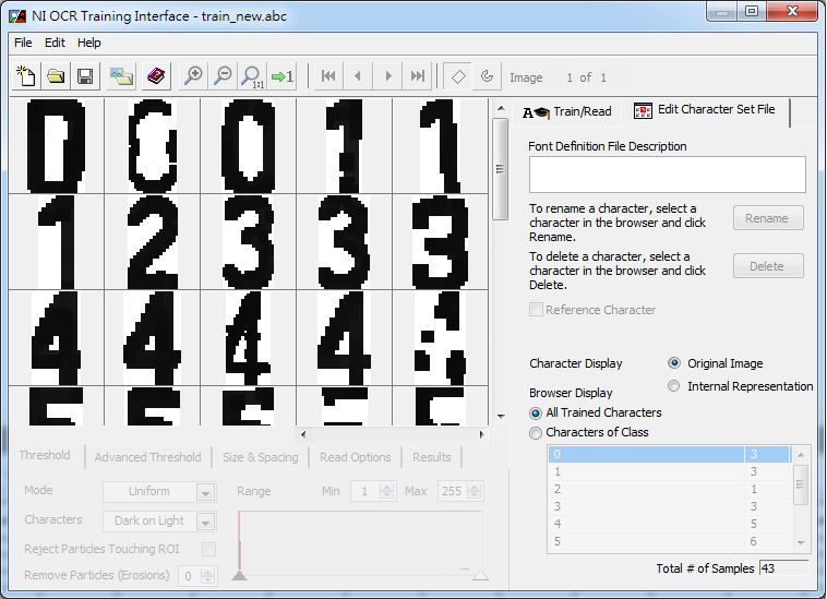

I have an application where Users have to train OCR characters. That is done.
Now I would like to have a button an a display that when the user presses the button all the characters trained appear in the display.
The same that in NI OCR Training interface:
But all of characters in a single display (because I don't know how many characters are going to have the users in every moment)

For the second question about joining images I have the next problem that I can not solve:
- In example you post the source code is just for four images and you know before running the code that there is 4 images.
- My problem is that I dont know how many characters are trained in the OCR Session.
- So I would like to visualize: 5 first character in the first  display arrow, next 5 in second arrow, next 5 in third arrow.... check image attached.
I dont know hoe to split the visualization characters by arrows.
I think that I have to use a for structure where N is equal to characters trained but I dont know how to do that split (because if I visualiza all characters in the same arrow that really anoying for the user)
