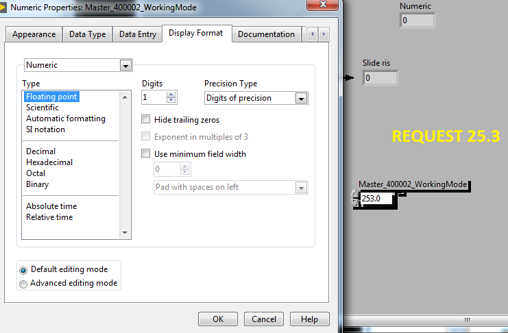

A temperature of 25.3° C is transmitted via modbus as 253
When I add the NUMERIC INDICATOR in the user interface VI, the displayed value is always without a comma.
I tried to change the view in DISPLAY FORMAT but I can not find the right combination.
What can I do?

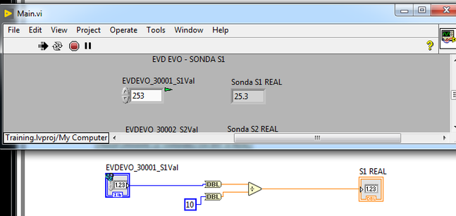

What about dividing by 10 and displaying the (float) result?

Converting the variable to FLOAT format in block diagram works.
But I would like to avoid working in the block diagram because I have about 100 variables to insert! Thanks

Showing the decimal point won't automatically show it at the 'right' place. So it would show 256.0, not 25.6. In other words, I don't think the decimal point does what you think it does.
Don't over-complicate things. You can leave out the "ToDBL" functions because LabVIEW will coerce the result automatically to DBL. Same difference, less code.
I fact you could create a subVI that does the entire scaling and make it the size of a single ToDBL function. 😄 (If you have LabVIEW 2017 or newer, you could even make it a malleable VI so it can take a scalar or array as needed)
