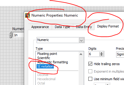

So I want the numeric controls to display numbers as 100m instead of 0,100 and 1n instead of 1e-9 etc, is it possible to do that with the settings?

Accepted by topic author dilge
(3,717 Views)
That was the funniest reply I've received! Smiley Happy Thank you, I had tried everything but not that option, I don't know why.

Here is another option.  Go download and install the following plugin:  Format Numeric Quick Drop Plugin.  Then use %#p for the format (see instructions on the page linked to).
