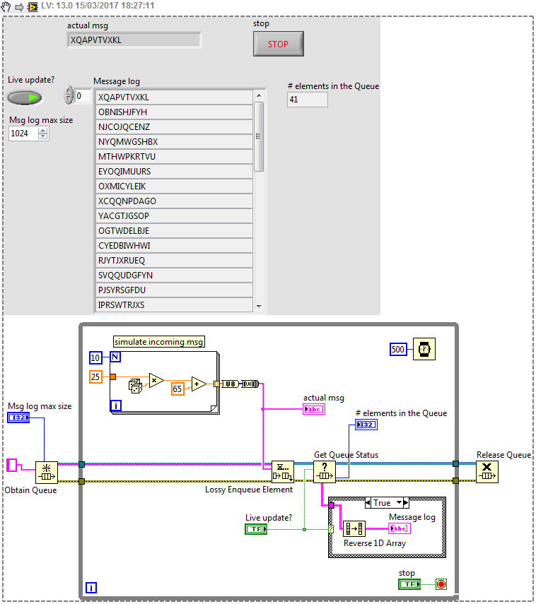

There are many different solutions. Here is one, not necessarily the most optimal in terms of speed etc, but can give you idea... Whatever solution you use, it is important that you need to limit the size of the log, otherwise you get a memory leak.
Here is the snippet (drag and drop into an empty block diagram):
(4,382 Views)
