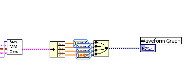

Hmm alright.  Then I guess the question becomes a little different now.  What would be the best way to take 4 separate 1-D arrays and have them output onto the same Waveform Graph?  This is what I had before.

Just use the Build Array.

Yeah that makes sense now.  I think I was just hung up in thinking the signal manipulation palate was what I needed to work with waveform types.  Thanks for the help Dennis.
