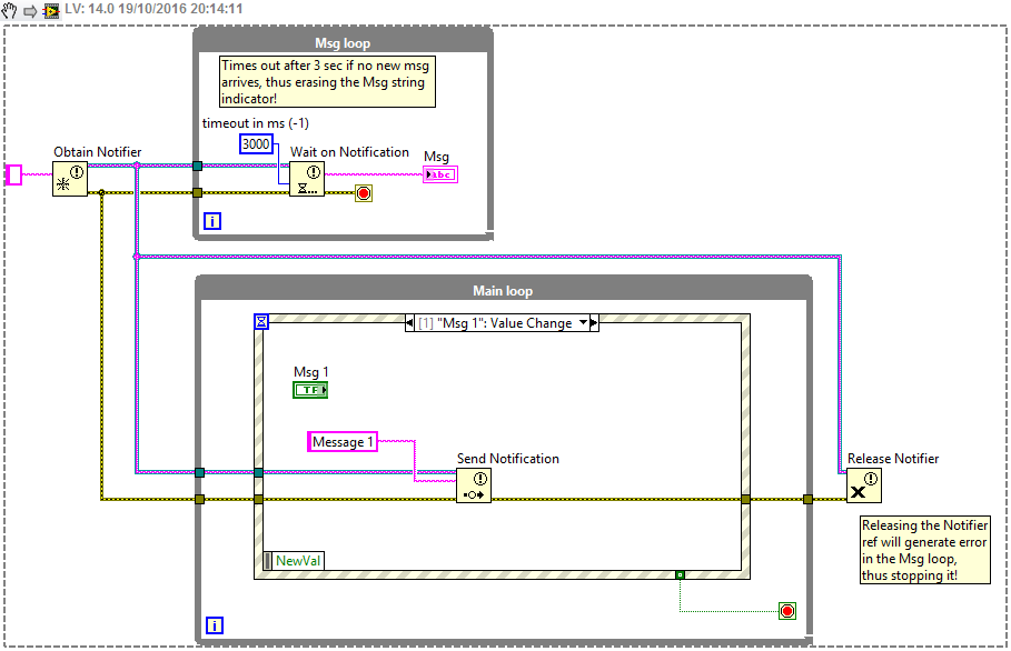

I put here a little example how a single Notifier could be used to send msgs alongside with an Event Structure:
Message 16 of 20
