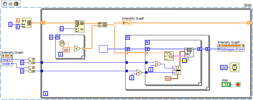

This is draft for one of solution. And it has error: you need inverse numbers by Y.
But I hope you can fix it.

Yes, typically, the Y scales in a graph go from top to bottom, max to min. The picture control goes from 0 to height.
The Y coordinates (as calculated right now) needs to be subtracted from the height.
Y (and X) scales can be flipped. So this needs to be considered when working on a general solution.
Another caveat: the picture control values are persistent. So the image is saved with the VI... That can be an unpleasant surprise when the graph is empty by default.
