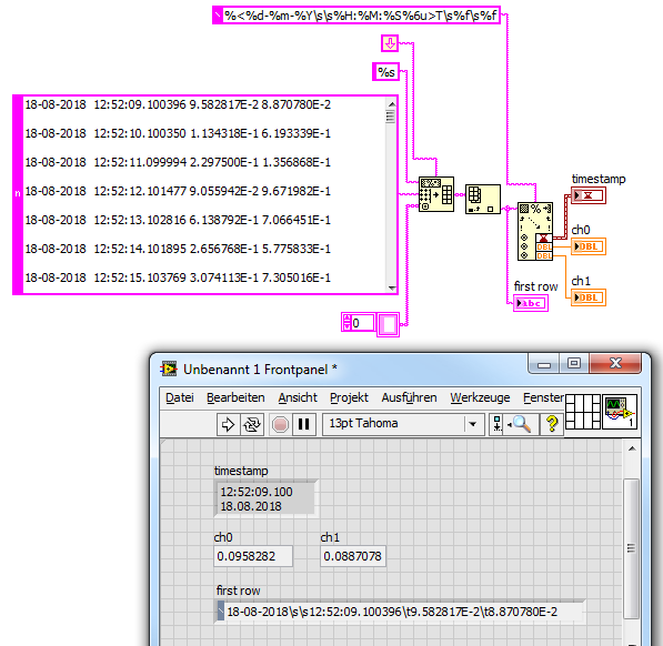

Thanks for your valuable guidance. I tried to format the timestamped data file but it is not showing the expected results (its showing an error too) and I am not sure whether it would process only the first sample or all of them. And I guess in your screenshot I will have to feed timestamp, ch0 and ch1 to a waveform graph for a proper display.
Can you plz tell me if I can display the data directly without formatting the file, using Read Delimited File in string mode? I have been stuck here since last one week, I would be very thankful to you if you can sort out my problem. 😞

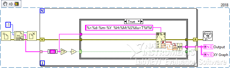

Why does your text file have extra line breaks in it.  It would be best if you could clean up the program that created this file so it didn't do that.
Otherwise, you can use the Read Text file functions to read it in a line at a time and discard every other line.  Keep the first and use scan from string to get the date/time time, and two data values.  The times looks like they repeat,, your first 8 rows are 2-18-2019 17:06:00.259742  so a waveform graph isn't a good option.  Waveform graphs expect equally spaced data.
You may want to use an X,Y graph.

I am trying to reformat the text file using 'Spreadsheet string to array' and 'Scan from string' functions but it is showing the following error:
"Error 1 occurred at Scan From String (arg 1) in format_data.vi"
Hence it is not generating timestamps and the two data values. Once I get these values then I can plot these on a graph.

Here is a snippet that might help you out. I'm plotting on an X-Y graph, though you know better how you want to display it.
