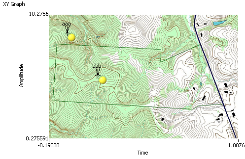

Hi Deepak,
      This seems like an interesing project, though it's still not clear to me the effect you're after.  The "create annotation" of XY graphs (in LV8.2) provides a dynamic creation with dragging effect.  The attached VI uses a transparent XY graph together with tst's idea of having a "cache" of controls - in this case boolean.  The controls appear and dissappear with the annotations...?
Cheers.

Hi , thanks for your replies..
                                            TBD::: I am unable to open the VI attached by you.
                                             Ok, i again want to explain my post.I am working on a gis type project where user can creat a predefined control by its own , on anywhere on the front panel.After creating that control user should be able to move it anywhere on the front panel.And in next step a new VI will open when user will click on the created Control or image(Predefined)
Everything should happent at run time , without stoping the application
And after finalising the architecture user shuld be able to rearchitect his/her design(user can delete created control).
