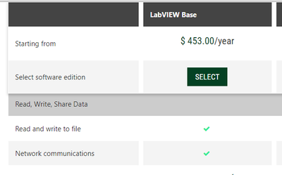

It should.  LabVIEW Base supports "network communications" per this page, which is all that it should need.
There's 3 or 4 different MODBUS libraries out there, and some of them are closed (password protected) so it's hard to be totally sure they will work but the open ones definitely should.
