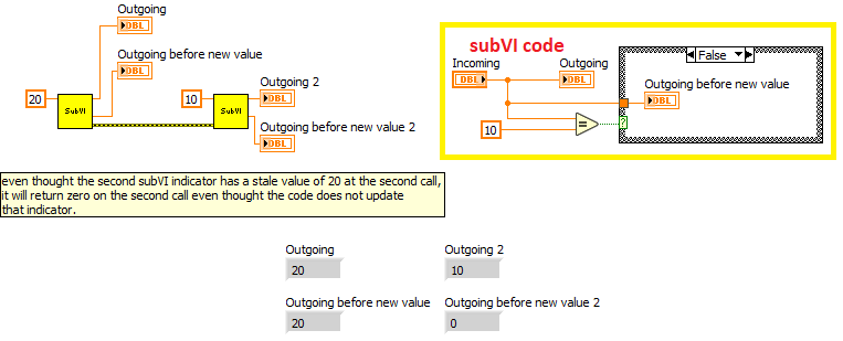

Here is the proof that the indicators remain the previous value from the last call.
This doesn't get into the subject of indicators that are in case structures.
LV17

It is possible that the indicator terminal is in a case structure case that is not always active, it might not always get new data with each call. Probably need to do some tests.
(OK, test was done and confirmed my suspicion. Last post was via phone, so I could not test but vaguely remembered some things)
So: The value is not retained if the indicator gets stale data AND is connected on the connector pane.
(OTOH, If the indicator is not connected on the connector pane, the subVI panel (when open) shows the last written value, 20 in this case).
Ravens example is just a plain race condition, because the terminal actually gets written on both calls.
