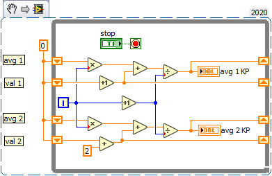

You're doing cumulative averages over a growing number of samples.   There's definitely a better way to do that without needing to grow any arrays.   The new average is a weighted average of the old average and the new value.   Basically, where N is the # values used used to determine the old average:
new_avg =  (N*old_average + new_value) / (N + 1)
Attached is a code mod to include this method next to yours to show that they agree.  Below is a snippet with just the new method.
-Kevin P
(1,471 Views)
Accepted by topic author GRCK5000
Hmmm, not sure where that snippet disappeared to.  Guess I'll try again.
Note: I edited the code down quick for the snippet without really thinking.  There should be a time delay in the loop.
-Kevin P

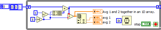

Here's what I might do. Same result!
... and if you don't like programming it yourself, use Mean ptbypt with sample lenght =0.
Of course your example is a bit random, because you can calculate these specific averages from first principles from the value of [i] alone.
Maybe you want to make an example that is more realistic, for example by generating new random values for each iteration.

Thanks Mr. Altenbach! This is awesome!!!
Thank you, KP! That definitely works.
