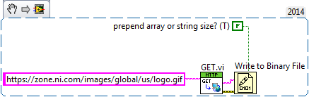

Hi Paolo1983,
If the URL is HTTP based then you can use the LabVIEW HTTP Client GET VI.
This is an example that does an HTTP GET and saves the result to disk by prompting you to choose where to save the file:
Note: Make sure to set prepend array or string size? to false when writing the binary data to disk

finlally It is working!!!
Thanks a lot for your help!!
